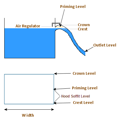

Crest
The level at which flow first starts to go over the siphon with the crest acting as a weir.

Crown level
The internal top level of the siphon tube. The Crown level minus the Crest level gives the height of the siphon tube.

Priming level
The water level at or below which the siphon will operate as a weir. Above this level the siphon will operate as a primed siphon.
You must satisfy the condition Crown level > Priming level > Crest level.

Width
The internal width of the siphon tube. The tube is assumed to be rectangular in cross-section.
For circular cross-section siphon tubes, the Width is the cross-sectional area divided by the height (Crown level - Crest level).

Hood soffit level
The level of the soffit hood.
A transitional flow regime is applied as the siphon becomes primed. The simulation engine will linearly interpolate between the weir and siphon (primed) equation values between soffit hood level and priming level.
