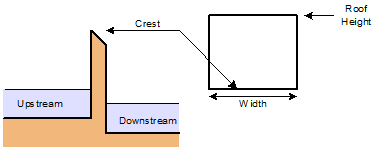

Crest |
The level at which the weir first comes into operation. For vee and trapezoidal notch weirs, and contracted rectangular weirs, this is the height of the base of the notch. For a gated weir this is the height of the sill. ICMLive Operator Client uses this as the initial value for a Variable Crest Weir or a gated weir unless overridden by the data entered on the Regulator Page.

Width |
The width of the rectangular weir. ICMLive Operator Client uses this value as the initial value for a Gated Weir or a Variable Width Weir unless overridden by the data entered on the Regulator Page. |

Roof height |
Roof Height for the weir (optional, more for pipes than open channel). If you enter a value here, the weir behaves as a sluice gate when the water level is above the roof height. If you do not give a value here, it is assumed that the weir does not have a roof. Applies only to WEIR, VCWEIR, and VWWEIR types of weir. |

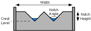

Notch height |
The vertical distance from the base (apex) of the notch to the top of the weir plate. Vee and Trapezoidal Notch Weirs only. |
notch_height |
Double |
L |
3 |
0.06 |
Notch angle |
The angle at the base (apex) of the notch in degrees. This means the full angle, not the angle of side slope. Vee Notch Weir only. Note: This angle is calculated automatically when importing data from SWMM5.
notch_angle |
Double |
ANGLE |
2 |
90 |
20 |
100 |
Notch width |
For Contracted Rectangular Weirs, this is the width of the single notch. For Trapezoidal Notch Weirs this is the width of the base of one notch. The weir may have more than one notch. The side slope of all notches is assumed to be 14 degrees. Contracted Rectangular and Trapezoidal Notch Weirs only.

Number Of notches |
You can have more than one vee or trapezoidal shaped notch in a weir. Enter the number here. All the notches are identical. Vee and Trapezoidal Notch Weirs only. |
