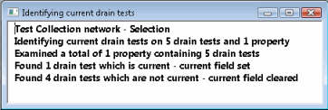

The query lists the number of drain tests and properties for the selected data source type.
Drain tests without associated properties are not examined.
Note:
Drain ID (injection point) and Survey Date / Time (see Drain Test Survey Data Fields for more information) are required for the identification of current drain tests.
If these parameters are not known for a given drain test, the user is informed that the status of this drain test is unknown.
The query compares the survey dates / times for every property ID / drain ID combination and identifies which drain test is the latest (current) one. Once a current drain test is identified, its "Current" check box gets checked (see Drain Test Data Fields). Similarly, the "non-current" drain tests get their "Current" check box unchecked.

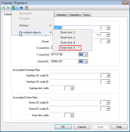

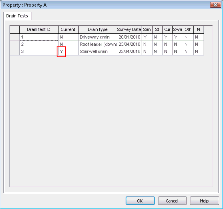

When navigating from a property to its associated drain tests, current drain tests can be easily recognised as they have:
  • a Y as an entry in the Current column, instead of an N (Object Properties Window).
  • an asterisk to the right of their name (tabbed Property Sheets).
Show me
