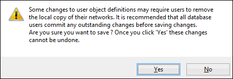

A message may be displayed warning that local copies of the networks may need to be removed, by users of the database, due to changes made to user defined objects.
- Click Yes to proceed.

- If changes have been made, click Save to commit them. The same warning message as the one displayed at relationship creation time may be displayed. It informs the user that:
- It is highly recommend for all users to commit any outstanding modifications before these changes to the user defined relationships are saved.
- Local copies of the network may need to be removed once changes to the user defined relationships have been committed.
