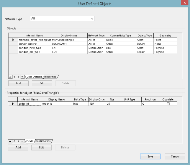

This dialog lets you to set up your own network objects, as user defined objects, and to define relationships for user defined objects and predefined (built-in) objects.
User Defined Objects Dialog
The dialog is displayed when Database management | Users defined objects is selected from the File menu.

Network Type
Dropdown containing network types. Available network types are:
  • All
  • Asset
  • Collection
  • Distribution
This filter restricts the display of objects and fields to those available to the selected network type only.
The objects and fields are displayed in the Object grid and the Properties grids respectively (see below).
Objects grid
This read-only grid contains two tabs, User Defined and Predefined, each of which displays a grid containing the following parameters:
  • Internal Name
  • Display Name
  • Network Type
  • Connectivity Type
  • Object Type
  • Geometry
The parameters in the User Defined tab define the object and are specified using the User Defined Object Grid, which is displayed when Add or Edit are selected. Newly created, but not saved, user defined objects will have a green background colour.
The grid shown in the Predefined tab is populated by InfoAsset Manager.

Properties grid
This read-only grid contains two tabs, the Fields grid and the Relationships:
Grid Description
Field
This grid shows the fields currently defined for the object currently selected in the Objects grid. The displayed parameters are the same as the ones specified in the User Defined Object Grid window, which is displayed when Add or Edit are selected.
Relationships
This grid shows the relationships currently defined for the object currently selected in the Objects grid. The displayed parameters are the same as the ones specified in the User Defined Relationship dialog, which is displayed when Add or Edit are selected.
See User Defined Relationship Dialog or Managing User Defined Relationships for more information.
Add
These buttons apply to the grid (Fields or Relationships) in focus:
Add - Add a new user defined field / relationship. The User Defined Field Grid and the User Defined Relationship dialog, are displayed respectively.
Edit - Edit the user defined field / relationship currently selected in the corresponding grid. This displays the User Defined Field Grid for the selected field or the User Defined Relationship dialog for the selected relationship.
Delete - Available for newly created but not saved fields /relationships - Delete the user defined field / relationship currently selected in its grid.
Edit
Delete
Save
Commit the changes and close the dialog.
Note: Changes cannot be undone and any added data cannot be removed so use Save with care.
Cancel
Cancel the changes and close the dialog.
