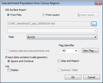

The Subcatchment Population Dialog is displayed as part of the process of
setting subcatchment population counts from address point data or census data. The dialog is displayed when Subcatchment
Population data from census areas or Subcatchment
Population data from address point counts is selected from the Model menu.
The options on the dialog vary depending on the menu option selected.
| Option |
Description |
| GIS Surface Import |
Choose the source from which the population data is to be imported:
Select the GIS field containing population data from the Field dropdown. |
| Update selected subcatchments only | Check this option to update the population field of currently selected subcatchments only |
| Flag Identifier |
Flag to be applied to changed data. Select an existing flag from the dropdown list or click the New Flag button to display the User Defined Flags Dialog. |
| Value for each Point |
Applicable to import from address point data only.
| If input data contains invalid geometry |
Applicable to import from census data only.
| Log |
