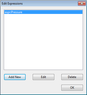

This dialog lets you add a new SQL expression or edit or delete an existing one.
This dialog is used when:
Displaying an SQL Expression by use of a theme (see Managing Themes for further information). The dialog is displayed when you click the SQL button on any of the themes of the Layer Theme Editor.
Exporting 2D element results to GIS files (see Exporting Results to GIS). The dialog is displayed when you click the 2D zone SQL Edit button in the GIS Export dialog.
Using the dialog
- To add a new expression, click Add New. Enter a name for the new Expression in the dialog and click OK. A simplified version of the SQL Dialog - SQL Page is displayed.
- To edit an existing expression, select the expression to be edited and click Edit. A simplified version of the SQL Dialog - SQL Page is displayed.
- To remove an existing expression from the list, select the expression to be removed and click Delete.
