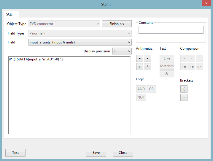

- In the Output Expression field, click
to display the
SQL Expression dialog, which can be used to type in the expression.
The TVD Connector - SQL Expression Dialog topic contains a list of the functions and operators which can be included in the expression.
If you are using the editor, then:
- Click Builder >>. This displays a set of buttons representing some of the operators that you can include in the expression.
- Specify the expression in the pane.
- Test the expression as described below.
- Click OK to save the expression and close the dialog.
You can use the Field dropdown list to select the database fields for the TVD connector that you want to include in the expression. The functions and operators which can be included in the expression are listed in the TVD Connector - SQL Expression Dialog topic.

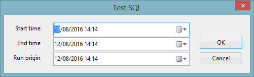

- Click Test. The
Test SQL dialog is displayed, which, as default, displays the current date and time.
- Use the dropdown calendar to set the start and end date and time to be used in the test. If the Field type is set to Run origin, then you will also need to set the run origin time.
- Click OK.

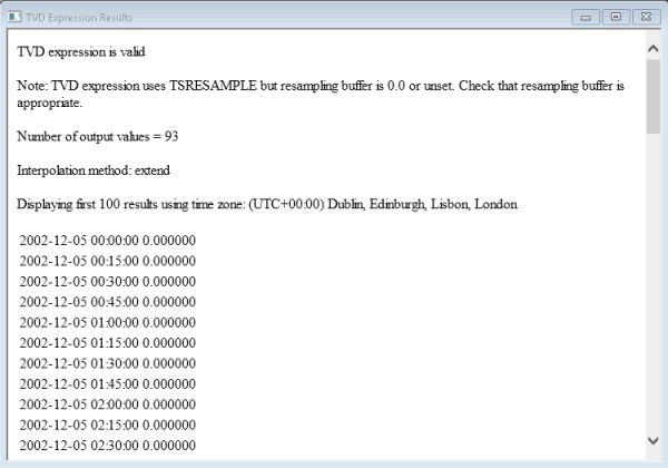

If the expression is valid, a window containing the results of evaluating the expression, is displayed.
Example of a Results Window for a Valid Expression

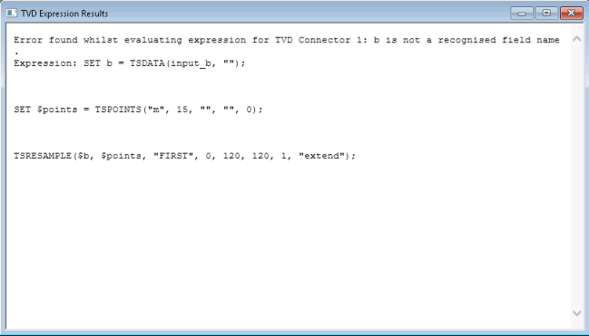

However, if the expression is invalid, a suitable warning message will be displayed in the window.
Example of a Results Window for an Invalid Expression
