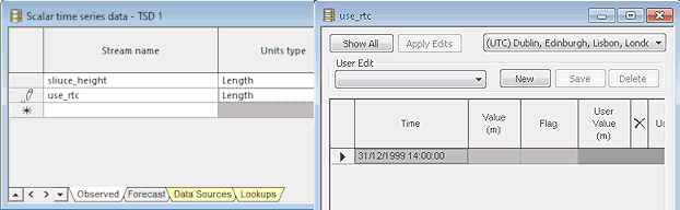

Set up an observed data stream, sluice_height, to control the height of the sluice gate during the observed period.
Set up a second data stream, use_rtc, containing one null value at a time before the simulation is to start.

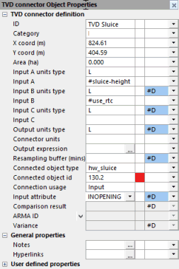

Set up a TVD connector linking the data streams to the sluice. Set Input units type to L and Input attribute to INPOPENING. Set Input A to #sluice_height i.e. the values read from the datastream connected to telemetry and Input B to #use_rtc i.e. the null value. Input B will be used when there are no data values for Input A.
The input to the TVD connector is a series of telemetry values from Input A until the end of the observed period, followed by a series of null values until the end of the run. These values are used as an input to control the sluice gate opening. The null values tell the simulation engine to use RTC.

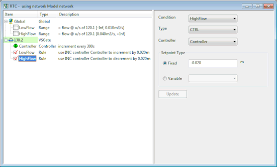

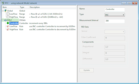

The table below displays the details of the RTC components required to control the flow through the sluice gate by using an incremental controller to control the setting of the sluice gate opening.
The steps required to use telemetry data to control sluice gate opening are described below.
Component |
Name |
Parameters |
Effect |

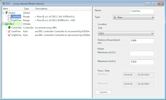

RANGE 1 |
LowFlow |
Range type: Q - flow Location link: 120.1 Minimum: Maximum: 0.010 |
Defines Link 120.1 as a control conduit with a maximum value of 0.010 m3/s
RANGE 2 |
HighFlow |
Range type: Q - flow Location link: 120.1 Minimum: 0.040 Maximum: |
Defines Link 120.1 as a control conduit with a minimum value of 0.040 m3/s

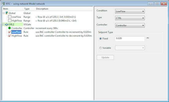

| CONTROLLER | Controller |
Type: INC Measurement Interval: 300 |
Defines that REGULATOR increments should be carried out every 300 s
RULE 1 |
LowFlow |
Condition: LowFlow Type: CTRL Controller: Controller Fixed: 0.020 m |
If the flow in Link 120.1 is less than 0.010 m3/s, increment sluice gate setting by 0.02 m
| RULE 2 | HighFlow |
Condition: HighFlow Type: CTRL Controller: Controller Fixed: -0.020m |
If the flow in Link 120.1 is more than or equal to 0.040 m3/s. decrements sluice gate setting by 0.02 m

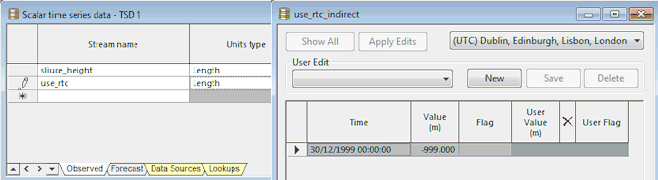

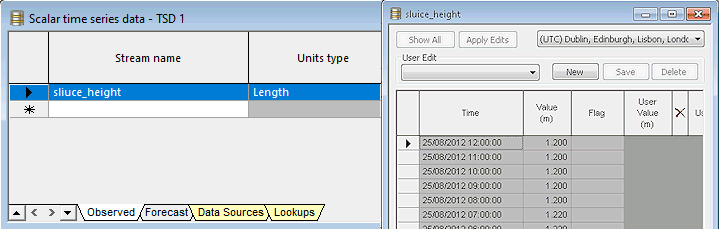

Set up an observed data stream, sluice_height, to control the height of the sluice gate when there are data stream values available.
Set up a second data stream, use_rtc_indirect, containing a value of -999, for example, at a time before the simulation is to start. Do not set a Data interval.

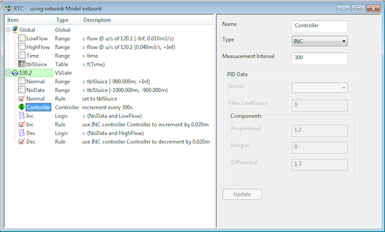

Edit the RTC so that the sluice_height data stream is used when values are available and the original RTC rules are used when a value of -999 is encountered.
Component
Name Parameters
Effect
RANGE 1
LowFlow Range type: Q - flow
Minimum:
Maximum: 0.010
Defines Link 120.1 as a control conduit with a maximum value of 0.010 m3/s (as original RTC)

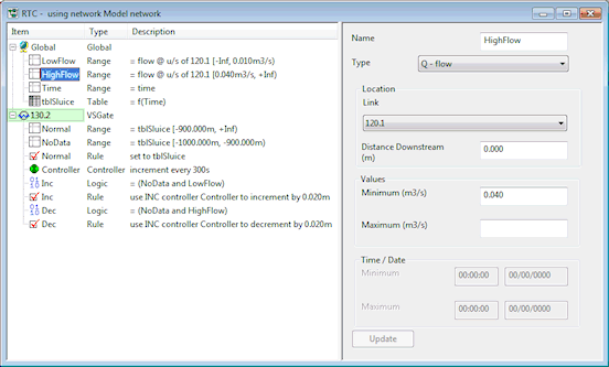

RANGE 2

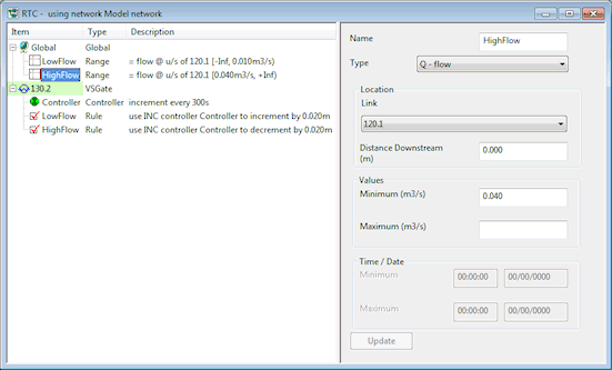

HighFlow Range type: Q - flow
Minimum: 0.040
Maximum:
Defines Link 120.1 as a control conduit with a minimum value of 0.040 m3/s (as original RTC)

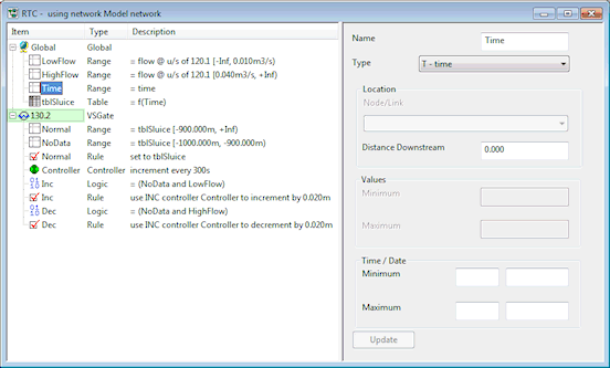

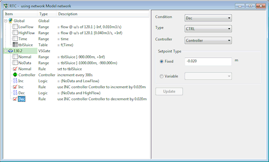

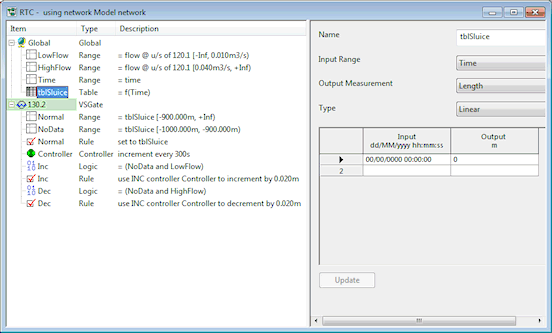

RANGE 3 Time Range type: T-time Time range to be used as input to Sluice opening table
TABLE 1 tblSluice Input Range: Time
Output Measurement: Length
Type: Linear
Input/Output grid: Time vs Length
Defines the relationship between time of simulation and the opening of the sluice gate. The records in the table will be supplied by the sluice_height or use_rtc_indirect data streams set up in Step 1 and Step 2.

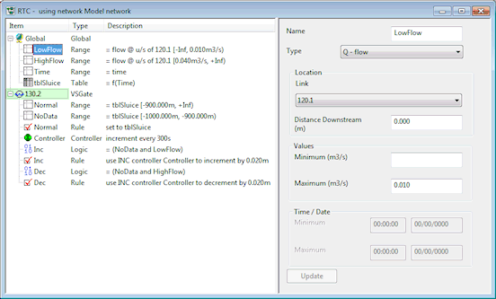

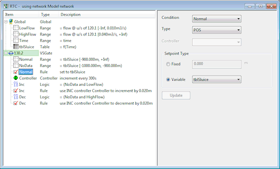

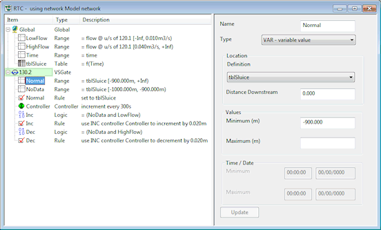

RANGE 4 Normal Range type: VAR- variable value
Location Definition: tblSluice (TABLE 1)
Minimum: -900 m
Defines a normal range where values provided for tblSluice by the TVD connector are greater than -900. (This will be when values are available from data stream sluice_height.)

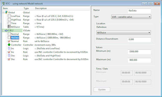

RANGE 5 NoData Range type: VAR - variable value
Minimum: -1000.000 m
Maximum: -900.000 m
Defines an erroneous range where values provided for tblSluice by the TVD Connector are between -1000 and -900. (This will be when values are not available from data stream sluice_height and are provided by data stream use_rtc_indirect.)
RULE 1 Normal Condition: Normal (RANGE 4)
Type: POS
Setpoint Variable: tblSluice (TABLE 1)
If the tblSluice values provided by the data streams are greater than -900, the sluice opening will be controlled by tblSluice.
(Data stream sluice_height values will control the sluice opening)
CONTROLLER Controller Type: INC
Defines that REGULATOR increments should be carried out every 300 s (as original RTC)

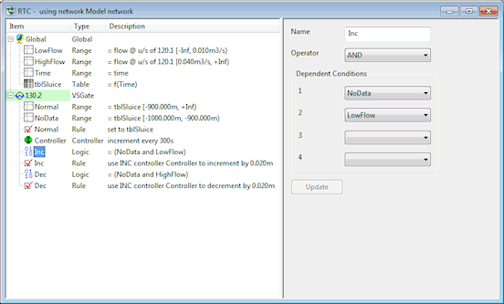

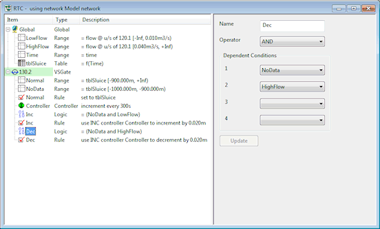

LOGIC 1 Inc Operator: AND
Condition 1: NoData (RANGE 5)
Condition 2: LowFLow (Range 1)
Check for tblSluice values in the NoData range and flow in Link 120.1 less than 0.01 m3/s

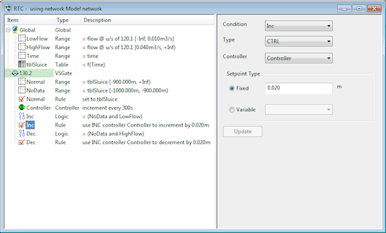

RULE 2
Inc Condition: Inc (LOGIC 1)
Type: CTRL
Fixed: 0.020 m
If tblSluice values provided by data streams are in the NoData range and the flow in Link 120.1 is less than 0.010 m3/s, increment sluice gate setting by 0.02 m
LOGIC 2 Dec Operator: AND
Condition 2: HighFLow (Range 2)
Check for tblSluice values in the NoData range and flow in Link 120.1 more than than 0.01 m3/s
RULE 3 Dec Condition: Dec (LOGIC 2)
Type: CTRL
Fixed: -0.020m
If tblSluice values provided by the data streams are in the NoData range and the flow in Link 120.1 is more than 0.040 m3/s. decrements sluice gate setting by 0.02 m

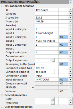

- Set up a TVD connector linking the data streams to the RTC table.
- Input units type: set to L
- Input A: set to #sluice_height i.e. the values read from the datastream connected to telemetry
- Input B: set to #use_rtc_indirect i.e. the -999 value. Input B will be used when there are no data values for Input A.
- Connected object type: set to hw_rtc
- Connected object id: set to tblSluice (the dropdown contains a list of RTC tables)
- Input attribute: set to INPRTCOUT
The input to the TVD connector is a series of telemetry values from Input A. When there are no values from Input A, the -999.0 value from Input B will be used. These values are used as an input to tblSluice in the RTC control.
When there are Input A values available, the Input A data stream values will be used to control the sluice gate opening via the RTC table tblSluice.
When the values from Input B are used, the original RTC control rules will be used to control the sluice gate.
