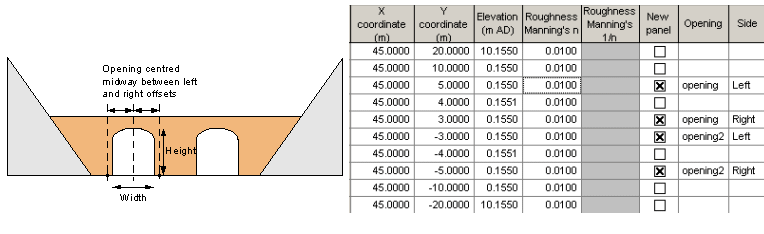

The locations of openings in the bridge are defined in the US bridge section data and DS bridge section data editors accessed via the Bridge property sheet:
- At the closest bridge section vertex to the left of the opening, specify the ID of the Opening object describing the geometry of the opening in the Opening column of the section editor and set the Side field to Left.
- At the closest bridge section vertex to the right of the opening, specify the ID of the Opening object and set the Side column to Right.
The opening will be centred midway between the Left and Right bridge vertices.
If the opening has already been digitised on the GeoPlan, it will be redrawn according to the locations defined in the bridge section data.
Note that if an opening is associated with a bridge, the geometry of the polyline representing the opening cannot be edited on the GeoPlan Window. The geometry is controlled by the definitions in the section data of the associated bridge.
Bridge section with two openings

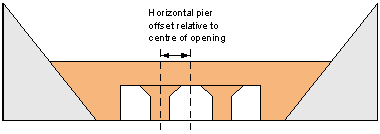

Piers
The geometry and location of piers within openings are defined in the Piers editor accessed via the Bridge Opening property sheet.
The location of the pier within the opening is defined by using the horizontal pier offset field. The pier will be centred at the specified offset relative to the centre of the opening.
