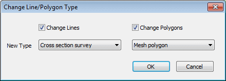

This dialog is used to change a selection of lines and/or polygons from their current type to another type.
It is displayed by selecting lines and/or polygons to be changed on the GeoPlan and choosing Selection operations | Change line polygon type from the Selection menu.
See Changing Line and Polygon Type for further details.
Show me
Check the Change Lines option to change all currently selected line objects to the type selected in the New Type dropdown.
Check the Change Polygons option to change all currently selected polygon objects to the type selected in the New Type dropdown.
Note: This functionality does not apply to Results section and 2D results polygon objects.
