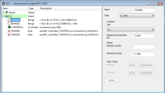

The RTC is defined by adding components to a Variable Discharge Orifice regulator in the RTC Window Editor.
Component |
Parameters |
Effect |
RANGE 1 |
Range type: Q - flowLocation link: H.1Minimum: Maximum: 0.580 m3/s |
TRUE if flow in conduit H.1 is less than 0.580 m3/s |
RANGE 2 |
Range type: Q - flowLocation link: H.1Minimum: 0.580 m3/sMaximum: |
TRUE if flow in conduit H.1 is more than or equal to 0.580 m3/s |

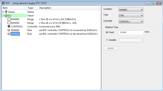

CONTROLLER 1 |
Type: INCMeasurement Interval: 300 s |
Measurement interval of orifice increment equals 300 s |
RULE 1
Condition: RANGE 1Rule type: CTRL Controller: CONTROLLER 1 Setpoint: FIXED 0.010 m3/s |
Increment REGULATOR by 0.01 m3/s if RANGE 1 is TRUE |
RULE 2 |
Condition: RANGE 2Rule type: CTRL Controller: CONTROLLER 1 Setpoint: FIXED -0.010 m3/s |
Decrement REGULATOR by 0.01 m3/s if RANGE 2 is TRUE |
- Range 1: Defines Link H.1 as a control conduit with a maximum value of 0.580 m3/s
- Range 2: Defines Link H.1 as a control conduit with a minimum value of 0.580 m3/s
- Controller 1: Defines that REGULATOR increments should be carried out every 300 s
- Rule 1: If the flow in Link H.1 is less than 0.580 m3/s, increments orifice setting by 0.01 m3/s
- Rule 2: If the flow in Link H.1 is more than or equal to 0.580 m3/s. decrements orifice setting by 0.01 m3/s
