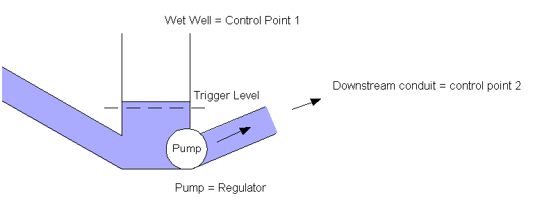

The following example shows the RTC for controlling the status of a pump depending on the depth in the controlling node and the flow in a downstream conduit.
Under this example, the pump will be switched ON when the level at node K reaches 20mAD, providing the flow in conduit K.2 does not exceed 0.5 m3/s. At other times, the pump will be switched OFF by default.

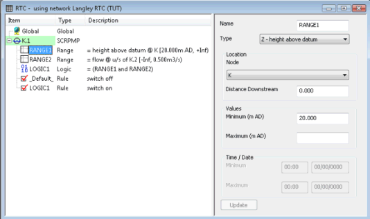

RANGE 1 |
Range type: Z - height above datumLocation node: KMinimum: 20Maximum: |
TRUE if water level at node K is greater than or equal to 20 mAD |

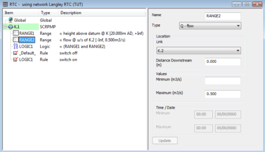

RANGE 2 |
Range type: Q - flowLocation link: K.2Minimum: Maximum: 0.5 |
TRUE if flow in conduit K.2 is less than 0.5 m3/s |

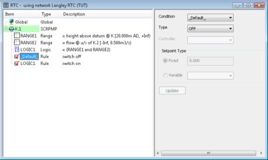

RULE 1
Condition: _default_Rule type: OFF |
Default status of pump is OFF |

- Range 1: Defines node K as a control point with a minimum value of 20 mAD
- Range 2: Defines Link K.2 as a control link with a maximum value of 0.5 m3/s

- Rule 1: Unless subsequent rules are true, the pump will be set to the default status of OFF
