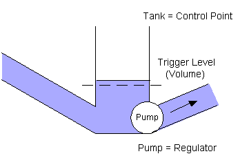

The following example shows the RTC for controlling the operation of a pump according to the volume in a chamber, by using a table to define the relationship between chamber level and volume.
Under this example, a pump is operated depending on the volume at a node.

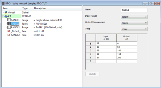

The relationship between the height above datum and the volume at the node is defined in a Table in the RTC.

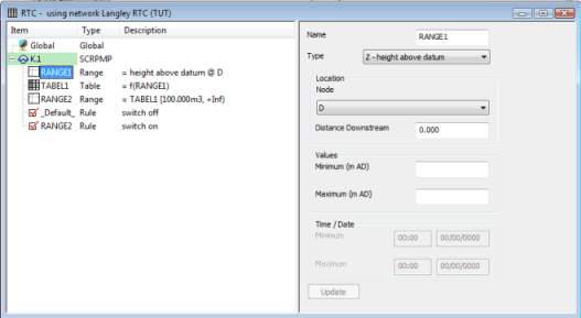

RANGE 1 |
Range type: Z - Height above datum Location node: D Minimum: Maximum: |
TRUE if height above datum is between - / + infinity |
TABLE 1 |
Measurement: Volume Input Range: RANGE 1 Type: LINEAR Input/Output grid: Height above datum vs Volume |
Relationship between range type defined in RANGE 1 and Volume at RANGE 1 location |

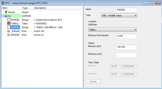

RANGE 2 |
Range type: Variable Location Definition: TABLE 1 Minimum: 100m3 Maximum: |
TRUE if volume is greater than or equal to 100 m3 |

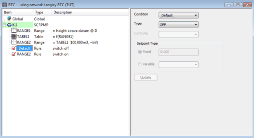

RULE 1 |
Condition: _default_ Rule type: OFF |
DEFAULT status of pump is OFF |

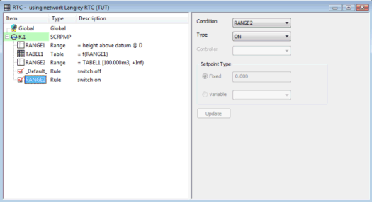

RULE 2 |
Condition: RANGE 2Rule type: ON |
Switch pump ON if RANGE 2 is TRUE |
- Range 1:
Defines node D as the control point
- Table 1: Defines the relationship between the depth at node D and the volume at node D
- Range 2:
Operates the pump according to the volume at node D
- Rule 1: Pump is switched OFF by default
- Rule 2: Pump is switched ON when volume at node D is greater than or equal to 100 m3
