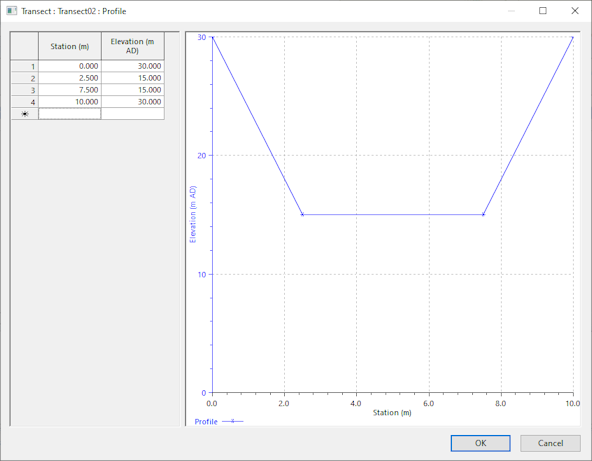

The Transect Editor is displayed when the button is selected in the Profile field in a Transect, and is used to specify the station (the distance from the left bank) and the elevation values which define the cross section of a custom shape type of conduit. The specified values will appear as the cross section profile in the graph.
Transect Example
Item Description
Grid / Graph
The station and elevation values entered in the grid will appear as the cross section profile in the graph.
