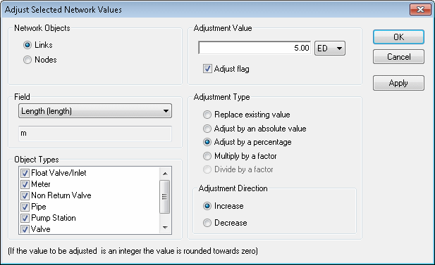

Adjust Selected Network Values dialog
This dialog allows you to replace or adjust the values of one or more fields for a set of selected network objects.
Before opening the dialog, you need to select all the network objects you want to change. Make sure no other objects are selected.
The dialog is displayed when you choose Selection Selection operations Adjust selected values.
For more information on the various methods of adjusting parameters for a group of network objects, see Editing Object Parameters.
Item Description
Network Objects
Choose whether you want to adjust nodes or links.
Field
Select the field you want to adjust. The list uses the field name from the database. The lower box displays the name you usually see on the grids and property sheets.
Object Types
Once you have chosen a field, the types of node or link for which this field is relevant are listed. You can uncheck types you do not want to change.
Adjustment Value
Enter the new value for the field here. For numeric fields you can replace the current value or adjust it by a factor. See below for more.
You can change the flag for the field at the same time. Check the Adjust flag box, then select a flag from the dropdown list.
Note: When adjusting integer values by a percentage or using a multiplier, non-integer outcomes are always rounded towards zero. For example, a value of 3.6 is rounded down to 3 while a value of -3.6 is rounded up to -3.
Adjustment Type
Replace existing value ~
Adjust by an absolute value
The amount entered is either added to or subtracted from the field for each of the selected objects.
Adjust by a percentage
The field is adjusted by either adding or subtracting the percentage.
Multiply by a factor
The field is multiplied by the factor.
Divide by a factor
The field is divided by the factor.
Adjustment Direction
If the option chosen was either Adjust by an absolute value or Adjust by a percentage, select whether the adjustment increases or decreases the value
