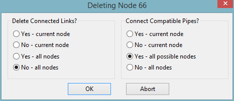

Deleting Node dialog
This dialog is displayed when deleting nodes connected to links.
Option Description
Delete Connected Links?
  • Yes - current node: deletes links connected to node displayed in title bar and then displays dialog again for the next selected node
  • No - current node: does not delete links connected to node displayed in title bar when node is deleted and then displays dialog again for the next selected node
  • Yes - all nodes: deletes links connected to all selected nodes in one action
  • No - all nodes: does not delete any of the links connected to selected nodes when the nodes are deleted
Connect Compatible Pipes?
  • Yes - current node: joins links connected to node displayed in title bar if the links are compatible and then displays dialog again for the next selected node
  • No - current node: does not join links connected to node displayed in title bar when node is deleted and then displays dialog again for the next selected node
  • Yes - all possible nodes: joins compatible links connected to all selected nodes in one action
  • No - all nodes: does not join any of the links connected to selected nodes when the nodes are deleted
When connecting compatible pipes, if there are differences in pipe values, the Resolving Connected Pipe Attributes dialog will be displayed.
OK button Carries out delete action
Abort button Dismisses dialog. No further deletion will be carried out.
