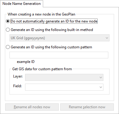

This page is used to:
  • set up automatic name generation options when creating nodes in the network
  • rename all or selected nodes based on a chosen naming scheme.
The page is displayed by selecting Network Network options, then, if necessary, clicking the Node Name Generation tab.
Node Name Generation page
Item Description
Do not automatically generate an ID for the new node If selected, disables automatic naming.
Generate an ID using the following built-in method
For automatically naming nodes based on coordinates.
If selected, the following options become available in the accompanying drop-down list:
  • UK Grid (ggxxyyxynn)
  • Irish Grid (ggxxyyxynn)
  • XY8 (xxxxyyyy)
  • XY10 (xxxxxyyyyy)
  • XY12 (xxxxxxyyyyyy)
  • XY14 (xxxxxxxyyyyyyy)
See Built-in methods, below, for an explanation of these options.

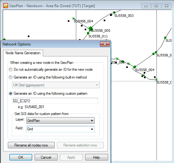

Generate an ID using the following custom pattern
For automatically naming nodes based on a custom pattern.
Custom pattern box
You use this box to enter a pattern for the automatic node names.
Type in text to appear in the node name and any variable items to be used.
Variable items go inside curly brackets. Variable items comprise a character identifying the source data followed by optional numbers indicating which particular digits/characters of the source data are to be used.
For example, entering the pattern {G}_{C321} would produced node names like SU5460_001.
See Variables for custom patterns, below, for a description of the variables that can be used to create naming patterns.
example ID For valid patterns, an example ID will be displayed here. For invalid patterns, an error message will be displayed here.
Get GIS data for custom pattern from
Available when using the {G} variable.
Layer: drop-down list of layers displayed in the GeoPlan.
Field: drop-down list of fields of the selected layer.
See {G}, below, for how to use this feature.
Rename all nodes now (button)
For renaming all the nodes in the GeoPlan, using the naming scheme selected above.
Available only if a naming scheme has been selected above.
Opens the Rename All Nodes dialog.
Rename selection now (button)
For renaming nodes currently selected on the GeoPlan, using the naming scheme selected above.
Available only if a naming scheme has been selected above and there is at least one node selected on the GeoPlan.
Opens the Rename Selection dialog.

{G}
GIS data from a nominated layer in the GeoPlan will be appended to the node name.
When using the {G} variable, the Get GIS data for custom pattern from section will become available. This section contains dropdown lists of layers displayed in the GeoPlan and the fields of the selected Layer. This is of particular use when using a coordinate grid layer.
Example
To adjust which characters of the GIS Layer Field appear in the node ID, add to the variable the digits corresponding to the location of characters in the field. The characters are numbered from left to right.
e.g. from layer field containing grid coordinates in the form SU5163
{G3456} = 5163
