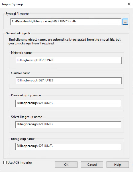

Import Synergi dialog
Synergi Water data comes in a Microsoft Access Database file (.MDB).
This dialog is displayed when you right-click the model group in the Model Group window and choose Import Model from Synergi v4 files from the context menu.
Tip: For details of the data read by the IWWS Synergi importer and any defaults/conversions imposed on this data, see the Synergi Conversion Notes topic.
For further information on the import process, see Importing Synergi Data.
Use the button to browse for the Synergi .mdb file in the Synergi filename box.
The object name boxes are automatically filled in with a name generated from the Microsoft Access Database filename, but the suggested name can be changed by the user.
