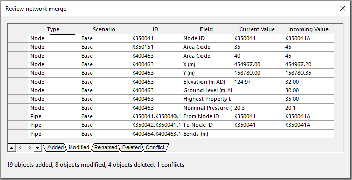

The Review network merge report displays the summary and conflicts when you merge a branch to the common base (parent) network using the
Merge changes from another network dialog.
The report shows, in their corresponding tabs, the objects that have been added, modified, renamed, or deleted.
The report also lists the various objects with conflicts. You can select whether to accept the incoming value or use the current value for each of the object listed.
In the Conflict tab, the Incoming Value (highlighted in green) is applied to the parent network. Clicking Undo changes this and makes the Current Value the one that is used.
Selecting the object in the report will highlight the object in the
GeoPlan.
Item
Description
Added
Type
The type of object that was added.
Scenario
The scenario where the object was added.
New ID
The asset ID of the object.
Modified
Type
The type of object that was modified.
Scenario
The scenario where the object was modified.
ID
Field
The field of the object.
Current Value
The value in the branch network.
Incoming Value
The value applied to the parent network.
Renamed
Type
The type of object that was renamed.
Scenario
The scenario where the object was renamed.
ID
New ID
The new asset ID applied to the parent network.
Details
Provides additional information regarding the change.
Deleted
Type
The type of object that was deleted.
Scenario
The scenario where the object was deleted.
ID
Conflict
Type
The object type of the given conflict.
Scenario
The scenario of the given conflict.
ID
The asset ID of the given conflict.
New ID
The new asset ID for the object (if applicable).
Field
The field of the given conflict.
Base Value
The value in the common base (parent) network.
Current Value
Incoming Value
Clicking Undo will change this and will make the Current Value the one that will be applied.
Undo
Check this box and the Current Value will be applied to the parent network.
Details
Provides additional information regarding the conflict.
Conflicts may arise if you (but not limited to):
- Renamed two objects to have the same name.
- Changed the type of an object that has already been added to the parent.
Context menu options
Edit Object
Opens the
Object Properties window for the of selected object where you can then view the fields values.
Find Object
Finds the object the in the
GeoPlan.
Select All Object
Selects all the objects in the list.
Commit History
Shows the
commit history
and you can go to details to view the commit information.
Undo
Undoes the change such that the current value will be used instead of the incoming value. This is applicable in the Conflict tab.
