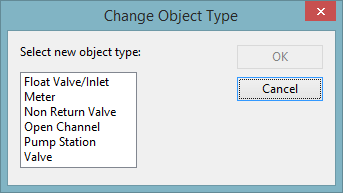

Change Object Type dialog
This dialog is displayed:
  • when you click the Change Type button on network object property sheets displayed independently of the Object Properties window, or
  • when you click the Change type (change type) tool in the Object Properties window.
Changing type is not available when the network is read-only.
Full details about changing the type of a network object, including important warnings about the implications of changing type, can be found in Changing network object type.
