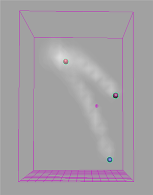

Emit fluid properties with nParticles
You can add fluid properties (Density, Temperature, Fuel, and Color) to a fluid container using nParticles. Like other methods of fluid emission, emitting fluid from nParticle objects creates fluid property values and modifies the voxels of a grid with the values as a simulation plays.
You can control the emission rate of fluid emitted from nParticles using the fluid emitter attributes or by using the nParticle per-particle rate and per-particle radius attributes.
Emit fluid from nParticles

Set fluid emission to nParticle per-point rate or per-point radius
You can use per-particle rate (Rate PP) and per-particle radius (Radius PP) attributes to control fluid emission rate. For example, you can set fluid emission radius to be based on the per-particle Radius values of the nParticle emitting the fluid.
