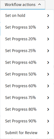

Update the progress of the activity
Now that the activity is in the In Work state, you may select from a number of percentage values to represent the completion level of the activity. This can be helpful for the project manager to ensure progress is being made on the project overall.
To update the progress of the activity:
  1. Open the activity.
  2. From the Workflow actions drop-down list, select the percentage level that you feel accurately describes the completion level of the activity.
  3. Optionally, enter a comment, then click Confirm.
activity progress
For the activity as shown on the Gantt chart, part of the bar representing the activity length is darker to visually indicate how much progress has been made on the activity. The progress bar on the activity is also updated with the value that you chose.

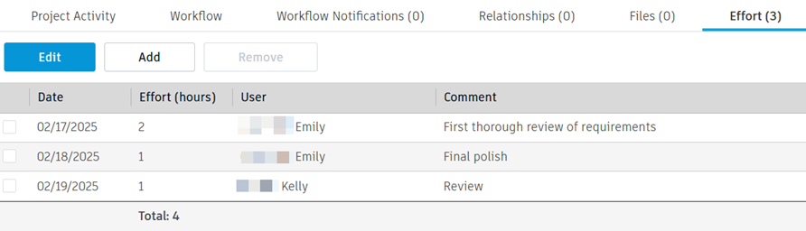

Activity effort
As you work on the activity, you should log the number of hours you have spent on it in the Effort tab.
activity effort
This total number of hours for the activity is rolled up and is shown in the Others section in the Project Activity tab of the activity once the activity has been completed. The total effort across all activities in the project is shown on the engineering project in the KPIs section in the Engineering Project tab on the engineering project.
