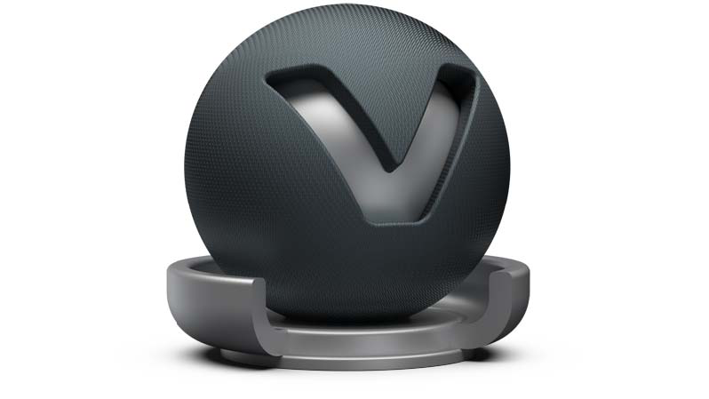

(Deprecated) Woven Cloth
Woven Cloth
Important:
As of 2026.2, a conversion option has been added for the deprecated woven cloth material. When loading a scene containing a woven cloth material, a dialog appears with the option to convert it into a plastic material with a sheen, recreating a similar, but not exact, material. Choosing Yes converts the woven cloth material. If No is chosen, nothing is converted; however, in Vulkan, all woven cloth materials will appear pink when rendered, but will be fine in other renderers.
The Woven cloth material contains presets for many common types of fabrics and allows the creation of a customized cloth material without using an external image-processing tool, such as Photoshop. Customized cloth patterns can also be used by importing a texture.

Woven Cloth Material
  • Diffuse Color - Defines the base color by setting the shader diffuse reflection color. This is the color the shader takes on when the light reflection of the surface is spread in many directions. Use the slider to change the brightness. Click the color field on the right to open the color chooser. Assigning a texture to the diffuse color projects it onto the surface. The appearance is a combination of the defined color and the assigned texture.
  • Darkening - Controls the appearance of the diffuse component. The default darkening value of 1.0 corresponds with a perfectly diffuse surface. Higher values than 1.0 darken the material, lower values brighten it up.
  • Warp/Weft Yarn Color - Sets the color of the vertical (warp) and horizontal (weft) yarn. Use the sliders to change the brightness. Click the color field on the right to open the related color chooser. It is best practice to use similar colors for warp and weft yarn.
  • Cloth Presets - Sets a handpicked material preset, which is also available in the VRED Example Assets in the Asset Manager. The parameters change automatically when a cloth preset is selected.
  • Weaving Pattern - Defines how the yarn is woven to cloth.
  • Yarn Type - Defines the glossiness of the yarn.
    • Staple Yarn - Simulates yarn that is made up of many tiny threads. Use this type for rough types of clothes such as denim.
    • Filament Yarn - Simulates yarn that is made up of one single untwisted, virtual yarn. Use this type for shiny types of clothes such as silk.
  • Yarn Twist Angle - Determines the glossiness of the yarn and depends on the choice made in the yarn type.
  • Highlight Width - Defines the width of the glossy highlight on the yarn segments.
  • Exposure - Defines the brightness of the glossy component.
  • Noise Intensity - Sets a natural noise effect for matt surfaces (staple yarn is recommended).
  • Moiré Removal - Softens the moiré pattern. The higher the value, the more effective the moiré pattern is softened. If too high, any structure is softened and surface information might get lost.
  • Warp Yarn Curvature - Defines the curvature of the vertical (warp) yarn.
  • Weft Yarn Curvature - Defines the curvature of the horizontal (weft) yarn.
