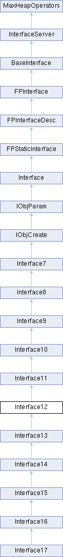

3ds Max C++ API Reference
Extends Interface11 Client code should retrieve this interface using GetCOREInterface12. More...
#include <C:/adskgit/3dsmax/3dsmax/3dswin/src/maxsdk/include/maxapi.h>
