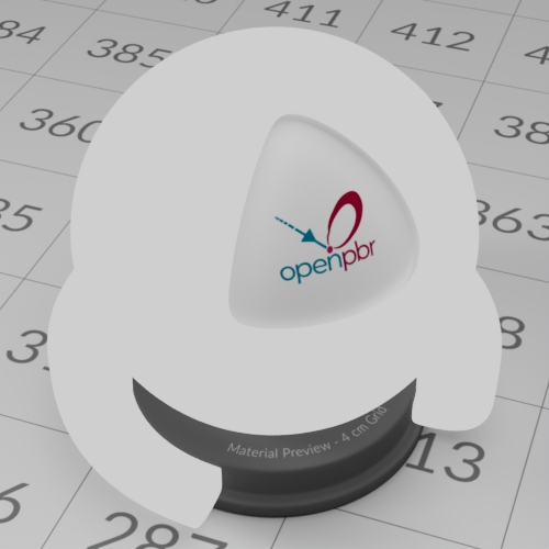

Luminance
Controls the amount of emitted light, specified as a luminance in nits (candela per square meter). This is the luminance that the surface would have if the emission color was white.
Emission with high luminance can create noise, especially if the source of indirect illumination is very small (such as light bulb geometry).
| 0 (default) | 500 | 1000 |
Increasing the number of Diffuse Samples helps reduce any noise in dark, indirectly lit areas of a scene when using emission.

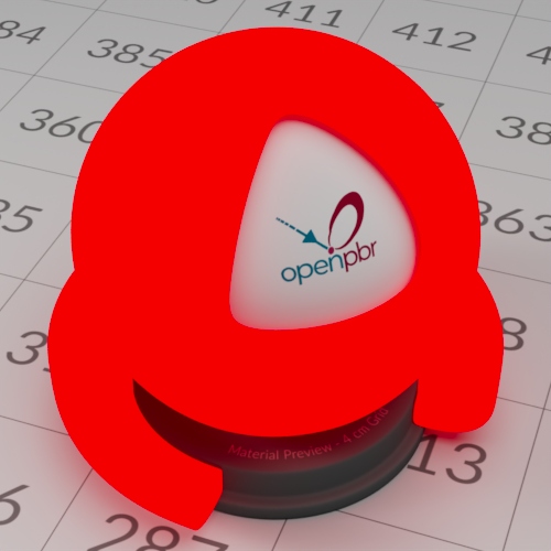

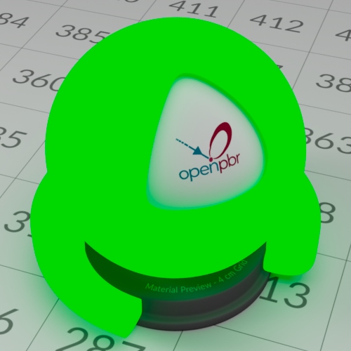

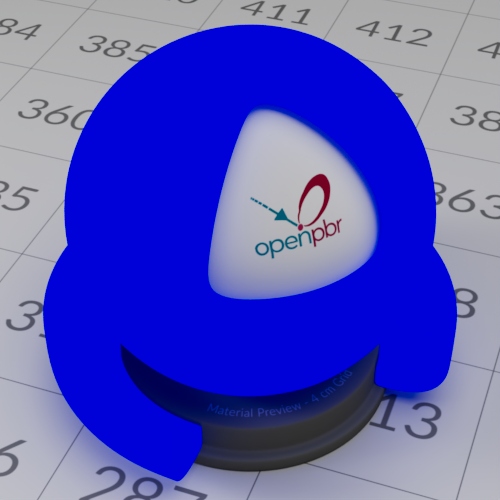

Color
The emission color is multiplied by the white light of the given emission luminance to obtain the final RGB emission.
| Red | Green | Blue |

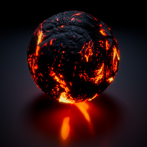

Texture map representing hot lava connected to emission color
