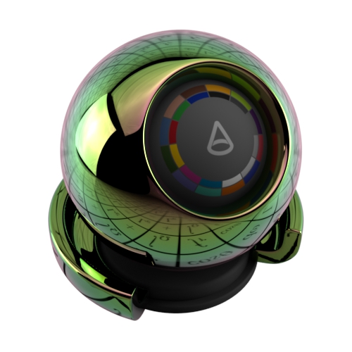

Thin film reproduces the effect of thin film interference on a surface. It can be used for materials, such as multitone car paint, burnt chrome, or the reflective coating on a beetle (Thin Film Thickness: 400, Thin Film IOR: 1.43).

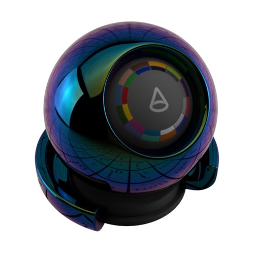

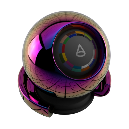

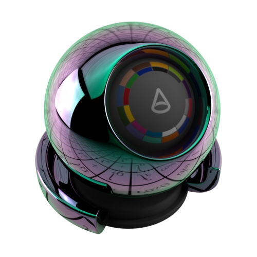

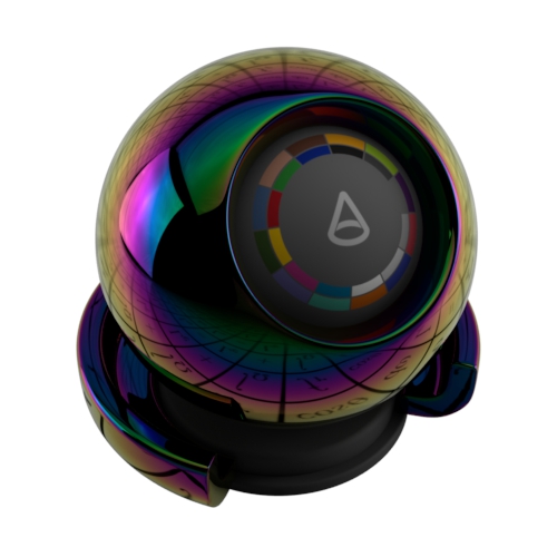

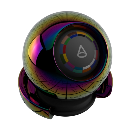

Thickness
Defines the actual thickness of the film between the specified min and max thickness (0 to 2000 (soft min/max)). This affects the specular, transmission, and coat components. Normally, this would be something like a noise map to give some variation to the interference effect. If the thickness becomes large, like 3000 [nm], the iridescence effect will disappear, which is physically correct behavior.
| 300 | 350 | 400 | 450 | 500 | 550 |

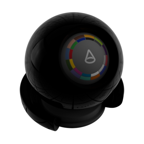

IOR
The refractive index of the medium surrounding the material. Normally, this is set to 1.0 for air.
| 1 | 1.5 (default) | 2 | 2.5 | 3 |

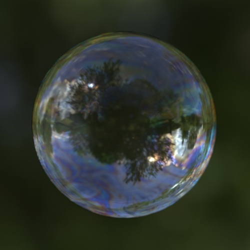

The IOR for water is 1.33, and soap is about 1.5. Therefore, the IOR for a soap bubble should be in the 1.33-1.4 range.
The following Standard Surface shader settings were used to create a soap bubble.
Base Weight: 0
Specular Weight: 1
Specular Color: 1 1 1
Specular Roughness: 0
Specular IOR: 1.0
Transmission Weight: 1
Transmission Color: 1 1 1
Coat: 1
Coat IOR: 1.5
Thin Film: IOR 1.4
Thin Film Thickness: 500 [nm]
A grayscale map should be connected (through a Range shader) to Thin Film Thickness if variation in the Thin Film is required.
More information about soap bubble color and film thickness can be found here.

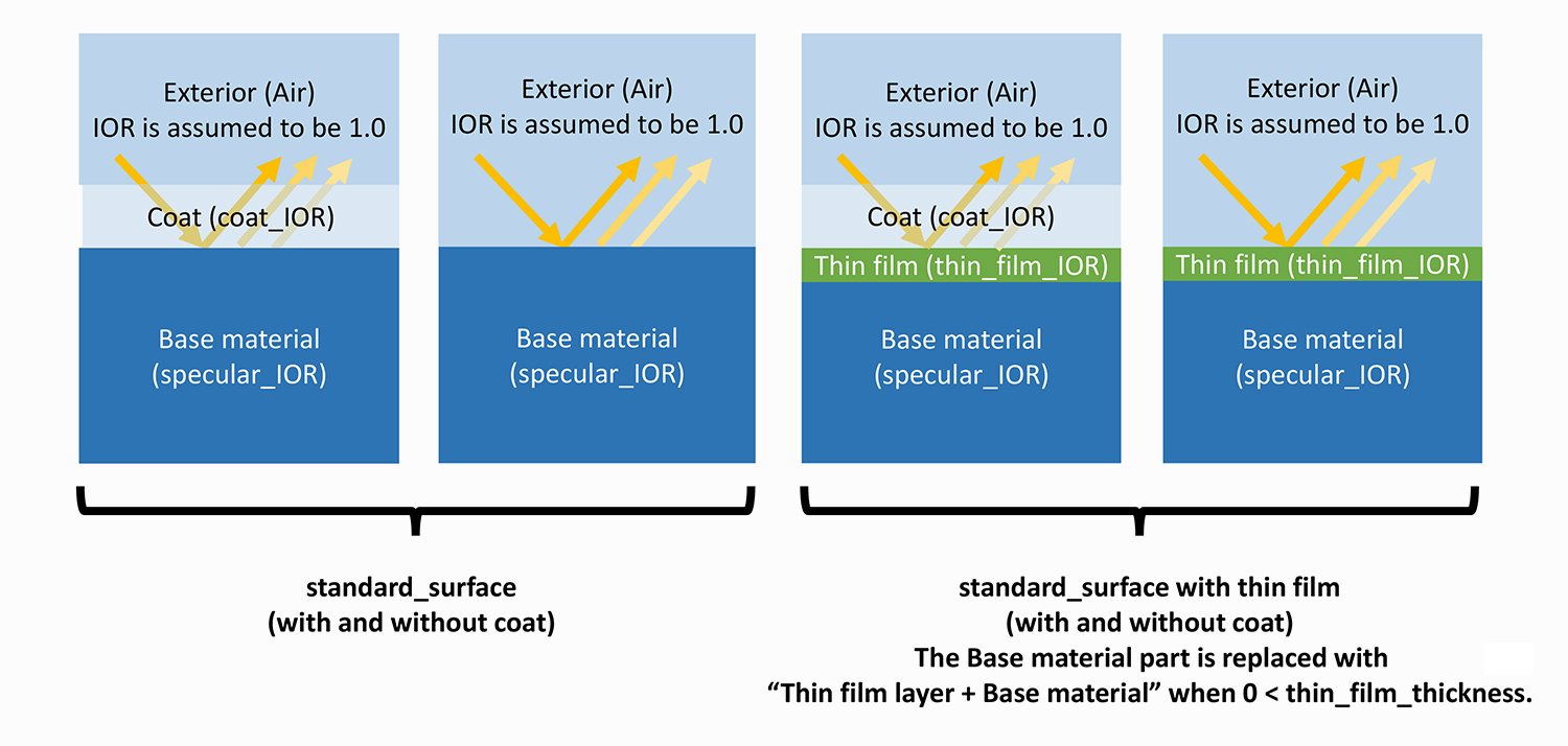

How Thin Film is Modeled
How to Map IOR values from Thin Film to Standard Surface
