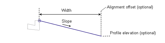

This subassembly is a general purpose utility to add a surface link by specifying its width and slope.
Either a % slope or ratio slope value may be given. An alignment or profile can be used when building a corridor model to allow variable width and slope.
The attachment point is at the inside edge of the link. This subassembly can be inserted in the left or right direction from the attachment point.
Input Parameters
Note: All dimensions are in meters or feet unless otherwise noted. All slopes are in run-over-rise form (for example, 4 : 1) unless indicated as a percent slope with a “%” sign.

Behavior
The link is added in the direction of insertion starting at the attachment point and going the given width and slope. If an offset horizontal alignment name is assigned to the Width during corridor modeling, the width of the lane will vary to match the offset of the alignment. If a profile name is assigned to the Slope, the slope is adjusted to match the profile elevation at the end of the link.
This subassembly includes an optional input parameter named Use Superelevation Slope that lets you specify to use the superelevation slope for the shoulder. This parameter can be set to a) Outside shoulder slope, b) Inside shoulder slope, c)Outside Lane, d)Inside Lane, or e) None. None is the default setting.
Layout Mode Operation
In layout mode, this subassembly displays the link at the given width and slope.
