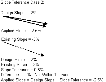

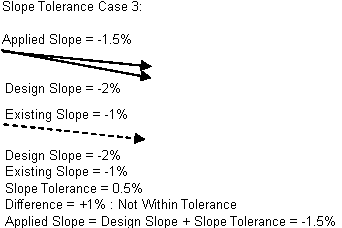

- If a numeric value or the superelevation slope is used, the overlay slope is compared to the existing slope between the sample points. If the difference exceeds the Slope Tolerance value, the design slope is adjusted up or down by the Tolerance value to make it more closely match the existing slope and minimize the amount of leveling or milling. Slope adjustment does not occur if the Slope Tolerance is zero.

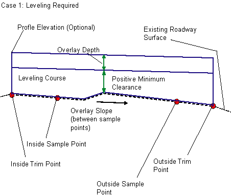

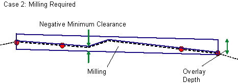

- If the Use Profile value is True, the elevation of the corridor profile is held at the Inside Trim offset on the top of overlay. The overlay is extended at the overlay slope to the Outside Trim offset, and a parallel link is inserted for the bottom-of-overlay. Any areas above the existing surface and below the bottom-of-overlay are stored as closed shapes with code “Level”. Areas below the existing surface and above the bottom-of-overlay are stored as closed shapes with code “Mill”.
- If the Use Profile value is False, the bottom-of-overlay link is shifted vertically to hold to the Minimum Clearance above or below the existing surface. A positive Minimum Clearance creates a leveling area above the existing surface and below the bottom-of-overlay. A negative clearance creates a milling area below the existing surface and above the bottom-of-overlay.

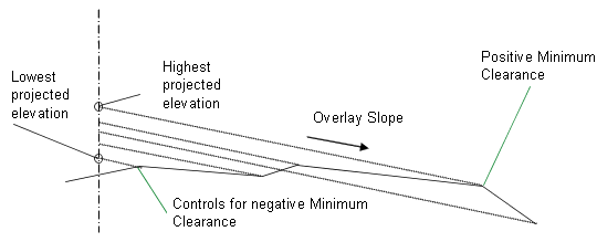

Minimum Clearance Point
The method of determining the point where the Minimum Clearanceapplies is shown in the diagram below.
- A vertical projection line is established at any arbitrary offset.
- Each point on the Existing Surface between the two trim points is projected back to the projection line at the Overlay Slope.
- The point with the highest elevation on the projection line is the control point for a Minimum Clearance value greater than zero. The one with the lowest is the control point for a Minimum Clearance value less than zero.
