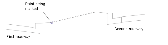

This subassembly is used to mark an existing point on the assembly with a name.
This is usually done so that other subassemblies can later insert links that attach back to this point (for example, LinkToMarkedPoint). The attachment point is the point that is marked. You can add user-defined point codes to this marked point.
In the example below, there are two roadways with independent profiles. Once the links for the first roadway are created, the point at the left outside edge is being marked. Later, after the links for the second roadway are created, a link can be inserted from its right outside edge back to the marked point.
Note:
If you use the MarkPoint subassembly with the LinkToMarkedPoint subassembly, in order for the LinkToMarkedPoint subassembly to work (draw) properly, it must be located below the MarkedPoint subassembly on the Construction tab of the Assembly properties. If the LinkToMarkedPoint subassembly is not located below the MarkedPoint subassembly on the Construction tab, you should select the Subassembly Group name in the Construction tab, then right-click and choose Move Up, so that the MarkedPoint subassembly is located above the LinkToMarkedPoint subassembly in the list.

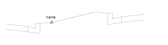

Layout Mode Operation
In layout mode, this subassembly draws a triangle symbol at the location of the marked point, and labels the marked point name above the point.
