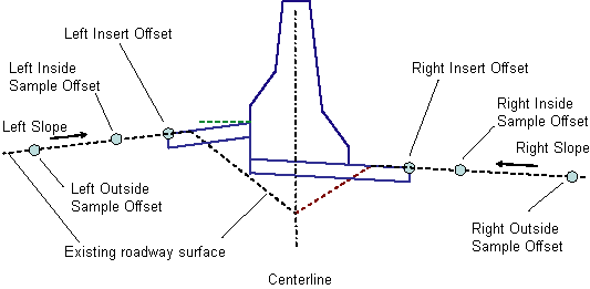

Left Insert Offset |
Offset where the median extension layer begins on the left side. |
Numeric |
0.0 |
Left Inside Sample Offset |
Offset of the inside sample point on the left side. The slope of the left side is calculated on the existing surface between the sample points. |
Numeric |
0.0 |
Left Outside Sample Offset |
Offset of the outside sample point on the left side. The slope of the left side is calculated on the existing surface between the sample points. |
Numeric |
0.0 |
Right Insert Offset |
Offset where the median extension layer begins on the right side. |
Numeric |
0.0 |
Right Inside Sample Offset |
Offset of the inside sample point on the right side. The slope of the right side is calculated on the existing surface between the sample points. |
Numeric |
0.0 |
Right Outside Sample Offset |
Offset of the outside sample point on the right side. The slope of the right side is calculated on the existing surface between the sample points. |
Numeric |
0.0 |
Dimension A (mm or inches) |
Height of the barrier from the base on the high side of the median to the top of the barrier. |
Numeric, positive |
810 mm 32 in |
Dimension B (mm or inches) |
As shown in diagram. |
Numeric, positive |
232 9 in |
Dimension C (mm or inches) |
Numeric, positive |
59 mm 2 in |
Dimension D (mm or inches) |
Numeric, positive |
125 mm 5 in |
Dimension E (mm or inches) |
Numeric, positive |
557 mm 22 in |
Dimension F (mm or inches) |
Numeric, positive |
178 mm 7 in |

Behavior
The left and right slopes are calculated between the sample points on each side. Lines from the cutout points are extended inward at these slopes to the centerline. The side with the highest elevation at the centerline determines the controlling side for the minimum height of the barrier.
The offset of the barrier base on the high side is calculated from the given dimensions. The overlay layer on the high side is extended from the cutout point to this offset.
The overlay layer on the low side is extended from the cutout point to the offset of the barrier base on the high side.
The barrier is constructed from the base point on the high side, closing to the top of the overlay layer on the low side, as shown in the diagram.
If a top-of-barrier profile is given as a target parameter, the height of the barrier is controlled by the profile. Dimension E may vary to achieve this height.

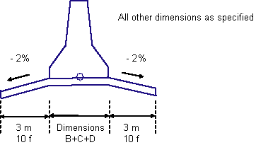

Layout Mode Operation
In layout mode, a symmetrical median and barrier are drawn with the fixed dimensions shown below. This is the same figure that is drawn in layout mode for the OverlayMedianSymmetrical subassembly.

Coding Diagram
The mirror image will apply when the high side of the median is on the right instead of the left.
