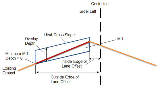

This subassembly overlays one side of an existing road, with a milling layer added as required.
The attachment point is the inside edge point of the overlay layer with finished grade cross slope.

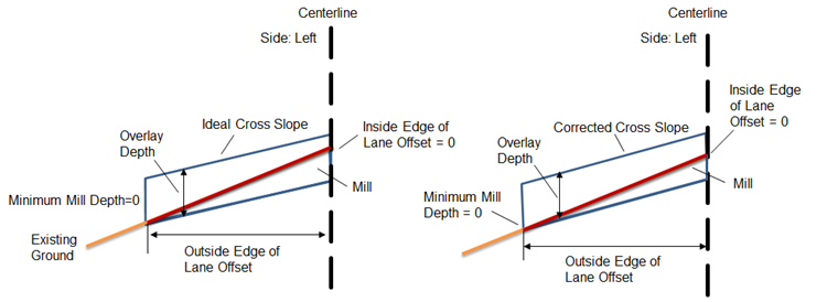

Overlay Depth Depth of the overlay layer. Numeric 0.300m
Overlay Slope Options Specifies overlay slope options.

Ideal Cross Slope Specifies user defined ideal cross slope. Numeric -2.00%
Lane Width The lane width, determined by the offset of the outside edge of lane from the inside edge of lane. Numeric 12.000m
Use Profile Options Select to tie the inside edge of overlay to a profile, adjust elevation to minimum level depth, or lock to previous subassembly.

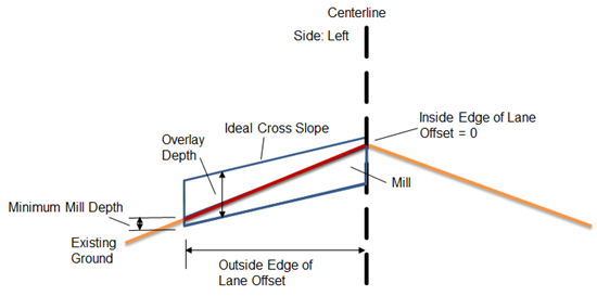

  • Minimum Level Depth
    The cross slope and elevation adjustments will meet Minimum Level and/or Minimum Mill Depth. The base is the existing surface.
  • Use Profile
    There will be no elevation adjustment. The elevation of the rehab subassembly attachment point will match the assigned profile. The cross slope adjustment will be determined by Overlay Slope Options.
  • Lock to Previous
    There will be no elevation adjustment. The elevation of the rehab subassembly attachment point will match the attachment point of the previous subassembly (in most cases this will be the previous lane's end point). The cross slope adjustment will be determined by Overlay Slope Options.
User Defined Minimum Mill Depth
Minimum Mill Depth The minimum mill depth between the bottom of the milling layer to the bottom of the existing ground layer. Numeric 0.300m
Slope Tolerance Tolerance for varying the overlay slope. Numeric 0.50%

Behavior
This subassembly assumes that no leveling layer is added.

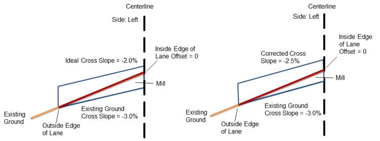

Case 1
Inputs:
Inputs
Ideal Cross Slope -2.0%
Minimum Mill Depth 0
Slope Tolerance 0.50%
Overlay Slope Options User Defined With Flapping
Use Profile Options Minimum Mill Depth
Calculations:
Input Value
Existing Ground Cross Slope -3.0%
Existing Ground Cross Slope - Ideal Cross Slope 1.0%
Slope Tolerance Existing Ground Slope minus Ideal Cross Slope is 1%, which is greater than the 0.5% Slope Tolerance
Corrected Cross Slope The Corrected Cross Slope will be -2.5%
Output Value
Corrected Cross Slope -2.5%

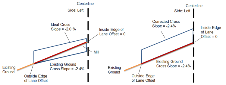

Case 2
Inputs:
Inputs
Calculations:
Input Value
Existing Ground Cross Slope -2.4%
Existing Ground Cross Slope - Ideal Cross Slope -0.4%
Slope Tolerance Existing Ground Slope minus Ideal Cross Slope is 0.4%, which is less than the 0.5% Slope Tolerance.
Corrected Cross Slope The Corrected Cross Slope will be -2.4%
Output Value
Corrected Cross Slope -2.4%

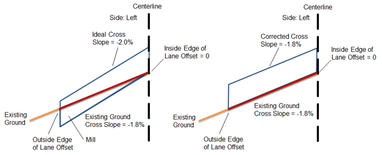

Case 3
Inputs
Calculations:
Input Value
Existing Ground Cross Slope -1.8%
Existing Ground Cross Slope - Ideal Cross Slope 0.2%
Slope Tolerance Existing Ground Slope minus Ideal Cross Slope is 0.2%, which is less than the 0.5% Slope Tolerance
Corrected Cross Slope The Corrected Cross Slope will be -1.8%
Output Value
Corrected Cross Slope -1.8%

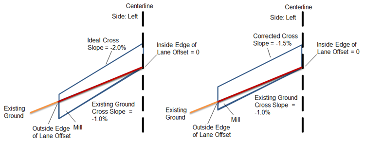

Case 4
Inputs
Calculations:
Input Value
Existing Ground Cross Slope -1.0%
Existing Ground Cross Slope - Ideal Cross Slope 1%
Corrected Cross Slope The Corrected Cross Slope will be -1.5%
Output Value
Corrected Cross Slope -1.5%
