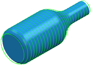

Rotary Finishing creates a toolpath by rotating the job around the Z axis, with linear motion provided by the X and Y axis pair.
This strategy is useful for machining cylindrical components.
This strategy does not support Boundary or other curve types.
This strategy is available only for the Mill Diam, Polar machining function in PartMaker/SwissCAM and PartMaker/Turn-Mill.
