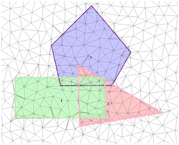

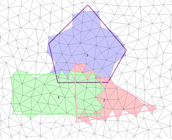

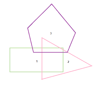

Used for clip meshing only. The priority assigned to this zone. If this zone overlaps another roughness zone, the intersecting part of the zone with the lowest priority value will have precedence over a zone with a higher priority value. When you create a 2D mesh, the roughness value that is assigned to each mesh triangle depends on what priority has been set for the roughness zone the triangle is located in. Any mesh triangles, whose centroid falls within an overlapping zone, will be assigned the roughness of the lowest priority overlapping zone if Exclude roughness zone boundary when creating 2D mesh is unchecked. If checked, all mesh triangles that fall within the overlapping zones will be assigned the roughness of the lowest priority overlapping zone. See the following example for further information. Example
Clip meshing will not occur if roughness zones with the same priority intersect or a value is not assigned to a zone. |
