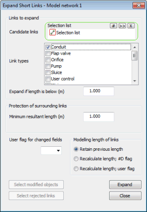

The Expand Short Links Dialog is used to set the options to be used when Expanding Short Links.
To display the dialog, select GeometryExpand short links from the Model menu.
The dialog options are:
Options Group Description
Links to expand
Defines which links in the network are to be considered for expansion:
Option
Description
Candidate links
Add a Selection List containing links to be expanded in the Candidate links Selection Box, or click the Current button to add the links currently selected in the GeoPlan Window.
Link types
Types of link to be considered for expansion.
When the Candidate links box is updated, the Link types list is automatically updated to only include the link types present in the candidate links selection.
Uncheck a link type to remove it from the set of links to be considered for expansion.
Expand if length is below
Enter the maximum length of links to be considered as a short link for expansion.
Only those links with length less than the value entered here (calculated from link geometry) will be expanded.
Protection of surrounding links
Defines options to be applied to links connected to the short links to be expanded:
Option Description
Minimum resultant length
Enter a minimum length for links connected to the short links to be expanded.
A short link will not be expanded if doing so would result in the length of a connected link (calculated from link geometry) falling below the value entered here.
User flag for changed fields
Select a flag from the dropdown list of user flags to be applied to fields modified as a result of the expansion process. Fields that may be modified due to expansion are:
  • length of modified links (user flag will only be applied if the Recalculated length; user flag modelling length option below is selected)
  • coordinate fields of moved nodes
Modelling length of links
Sets the option to be used when recalculating lengths of expanded links and links connected to expanded links:
Option Description
Retain previous length
Length of links prior to expansion is retained.
Modified links with the default #D flag originally applied to the link Length field, will have the Length flag cleared.
Recalculate length; #D flag
Length of modified links is recalculated from link geometry.
The default #D flag is applied to the Length field of the link.
Recalculate length; user flag
The user flag selected from the User flag for changed fields dropdown list is applied to the Length field of the link.
Select modified objects button
Enabled after the expansion process has been carried out.
Click this button to highlight all modified objects (candidate links and their connected links) on the GeoPlan Window.
Select rejected links button
Click this button to highlight links that could not be expanded on the GeoPlan Window.
(Links may be rejected due to a number of constraints, for example, if expansion would result in the length of a connecting link being reduced to below the specified Minimum resultant length.)
Expand button
The Expand button is enabled when there is at least one link in the Candidate links selection of a type selected in the Link types box.
Click the Expand button to carry out the expansion process.
Close button
Click the Close button to dismiss the Expand Short Links dialog.
