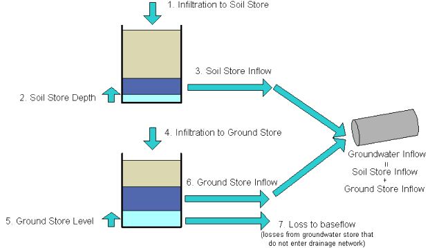

InfoWorks ICM models rainfall-induced infiltration and groundwater infiltration using a double reservoir model. The two reservoirs represent soil storage and ground storage. Dry weather infiltration and tidal infiltration are accounted for via their effect on the groundwater table. The infiltration model uses bulk mass balance equations and simplified flow equations to approximate the physical processes. Because the model is simplified it requires some degree of calibration.
Ground Water Infiltration Model
Rainfall runoff has three model components: initial loss (depression storage), runoff volume and runoff routing. Incident rainfall is initially stored in surface depressions, which are subject to evaporative loss (defined in the rainfall event). When rainfall exceeds depression storage in a given time step, a proportion of the excess rainfall goes to runoff according to the particular volume model used. The remaining rainfall is directed into the soil storage reservoir. When the soil reaches a given saturation threshold (the percolation threshold), water starts to percolate downwards. A proportion of this percolation flow (the percolation percentage infiltrating) infiltrates directly into the network while the remainder penetrates deeper to feed the groundwater storage reservoir. Note that the volume in the soil storage reservoir is also subject to evapotranspiration, though at a reduced rate.
When the groundwater storage reservoir reaches a particular threshold water loss due to baseflow occurs. When the groundwater level reaches a further infiltration threshold, groundwater infiltration occurs.
The infiltration model can be calibrated so that the ground water storage level relates to the actual groundwater table level. In this case, the infiltration threshold type and baseflow threshold types are set to levels that are relative to the chamber floor of the node that the particular subcatchment drains to. This is a reasonable estimate of the realistic level at which infiltration may occur.
In networks where infiltration is dominated by tidal influences, a time-varying profile for the groundwater storage level can be defined. This profile overrides the level calculated by the infiltration model and groundwater infiltration is then based on this level.

The equations used to model the soil storage reservoir and the ground storage reservoir are described below.
The Soil Storage Reservoir
The losses from the soil store are evaporation and percolation, Qp, to the groundwater store. The input into the soil store is Qsoil. The continuity equation for the soil store is:
(3)

The Ground Storage Reservoir
The input into the groundwater store, G, is Qground. The losses from the groundwater store are baseflow, Qbaseflow, and groundwater infiltration, Qgi. The continuity equation in the groundwater reservoir is:
(6)
