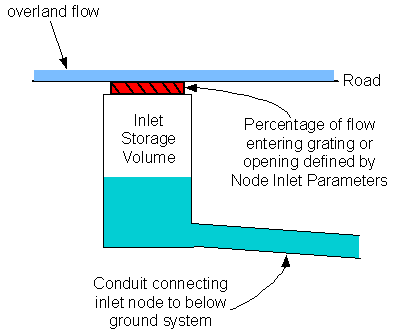

Inlet Nodes are used to model storm drain inlets. These inlets intercept flow from the overland system and pass it to the underground storm drainage system. Inlets are typically located in roadside gutters.
Modelling Inlet Nodes
To define a node as an Inlet in InfoWorks ICM, select the Inlet option in the Flood Type field of the Node.
The inlet defines the amount of overland flow discharging into the node storage volume. The amount intercepted is calculated according to a set of specified inlet parameters.
Schematic Diagram of Inlet Node

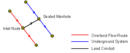

The inlet storage may be connected to the underground drainage system via a 'lead' conduit which may act as a constriction to flows entering the drainage system. If no lead conduit is modelled, it is assumed that one does not exist and therefore no constriction is modelled between the inlet and the main system.
Inlet with Lead Conduit Modelled
