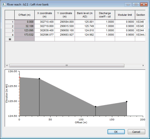

River Reach - Left river bank editor
Section points grid
Offset (cross chainage) values are automatically calculated from X and Y coordinates, but are not exported or imported when exporting to / importing from external files.

Note: River bank section data is read only by default as it is intended that bank parameters, including geometry, be built from river line data. If changes to bank parameters are required, these should be made to the line data and the reach updated from the line data. However, section data can be made editable by checking the Allow editing of river reach data option of the General page of the Options dialog.

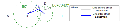

  • Edit Offset - display the Edit Offset dialog. Enter an offset value between the offset values of adjacent vertices and click OK. The offset of the point clicked on will be adjusted. X coordinate and Y coordinate values of the vertex will be calculated from distance from adjacent vertices, whilst maintaining the original offsets of the adjacent vertices.
    For line ABCDE, a new offset is specified for vertex C (shown as C'). The position of C' is calculated by finding the point that is distance BC' from vertex B and BC+CD-BC' from vertex D.

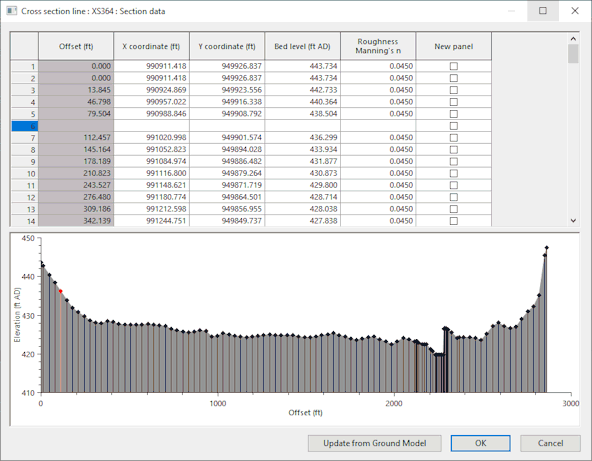

Section profile graph
A graph of the profile of the currently selected section is displayed at the bottom of the editor.
When viewing Bridge or River Reach data; selecting points on the graph will temporarily highlight section vertices on the GeoPlan by drawing a small box round the selected vertices.
Right-click on the graph to display a context menu that includes options that allow different properties of the graph to be turned on or off.
If a ground model is loaded onto the GeoPlan Window, a trace displaying the ground model elevation can be displayed.
If results are loaded onto the GeoPlan Window, a trace displaying the water level at the current timestep will be displayed.

This button is only available when editing section data for a Cross Section line.
Cross section line editor
When you click Update from Ground Model,and a ground model is loaded on the GeoPlan, the cross section data is automatically updated with levels from a ground model, and an Update from Ground Model Report is displayed. A message is displayed if a ground model is not loaded.
See Updating Network Objects from the Ground Model for further information.
