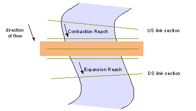

The Bridge object consists of five cross sections:
  1. US link section - upstream end of the link (generally the same section as the downstream section of the previous river reach). The distance between this section and the US bridge section defines the length over which contraction of flow occurs.
  2. US bridge section - upstream face of the bridge, usually located at the upstream toe of the road embankment, or at a short distance downstream of the bridge.
  3. Bridge deck - bridge deck section at the centre-line of the deck.
  4. DS bridge section - downstream face of the bridge, usually located at the downstream toe of the road embankment, or at a short distance upstream from the bridge.
  5. DS link section - downstream end of the link (generally the same section as the upstream section of the next river reach). The section should be located at a distance downstream from the structure where flow has fully expanded and is not affected by the structure.
Plan view of bridge cross sections
