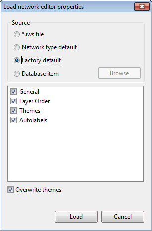

Load Network Editor Properties Dialog
This dialog is used to load previously saved settings of properties associated with the network.
The properties that can be loaded are:
  • GeoPlan themes and properties
  • Long Section/Section properties
  • Grid layout column order
The dialog is displayed when you click Load on any page of the GeoPlan Properties dialog or the Section Properties dialog or when Load grid layout is selected from the Grid menu.
An example of the dialog when opened from the GeoPlan Properties dialog
Dialog description
Option
Description
*.iws file
Loads an existing GeoPlan Properties file (IWS extension).
Selecting this option and then clicking Browse, displays a Windows standard Open dialog, allowing you to browse for the IWS file.
Refer to the Network Editing Properties - Save Options dialog topic for details on how to export GeoPlan properties and themes to an iws file.
Network type default
Overwrites the current settings with the user default settings for the current network type.
Refer to the Network Editing Properties - Save Options dialog topic for details on how to save current properties and themes as user defaults for all networks of the same type.
Factory default
Overwrites the current settings with the system settings.
Click Yes on the subsequently displayed message to confirm the operation.
Database item
Loads an existing Themes database item.
Selecting this option and then clicking Browse displays the Common Tree Selection dialog. Select the theme to be loaded from the tree and click OK.
(This option is disabled for Section properties and Grid layout properties.)
Properties and Themes box
A context list that lets you choose which properties are to be saved.
By default properties that have had changes to them will be checked when the dialog is first opened.
Overwrite themes
A check in this box indicates that existing sub-themes will be overwritten with new ones.
If this box is not checked, when themes are loaded they will not overwrite existing sub-themes of the same name in the same layer.
