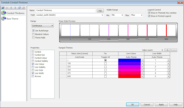

Example
This section shows an example illustrating link thickness in an InfoWorks ICM network.
The following screenshot shows the factory default GeoPlan themes on a test network.
- In the GeoPlan Properties - Layers and Themes page, click Edit in the Theme column for Link
- The Conduit Layer Theme Editor is displayed.
- Click Add (
) of the Sub Theme Manager Theme to add a new theme.
- Enter a new name for the theme, for example Conduit thickness.
- Select conduit_width (Width) in the Field box.
- Click three consecutive times on the Plus button to add 3 intermediate values ("bins").
- Choose a Line Colour for the first and last values.
- Click Auto-Theme to generate a graduated set of colours for the intermediate values.
- In the Properties section, check Line Width in order to add this property to the Ranged Themes grid.
- Set a line width for the first and last value.
- Click Auto-Theme to populate the intermediate line widths.
- Click OK in the Layer Theme Editor to save the theme.
- Click OK to close the Layers and Themes page of the GeoPlan Properties dialog.
