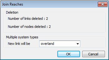

Join Reaches Dialog
The Join Reaches Dialog is displayed as part of the joining river reaches process.
The dialog displays details on how many links and nodes will be removed in order to merge currently selected reaches.
If the river reaches to be merged are of different system types, the system type to be applied to the merged reach can be selected.
