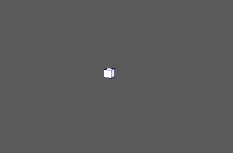

Adds spring to an existing animation. As such, it requires animated MASH node input.
MASH Spring
