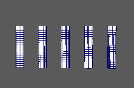

- Stagger Frames
- Determines how many frames to wait before animating the next object in the MASH network.
- Random Stagger
- Waits a random number of frames before animating the next object in the MASH network. When enabled, Stagger Frames represents the maximum number of frames Maya will wait.

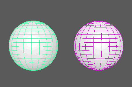

- Simulated Time
- Determines how the
Time Scale is applied to the animated objects.
When disabled, the animation time is multiplied by the Time Scale. In this example of a MASH reproduced shrink wrap, Time Scale is reduced from 1 to 0. Note how the MASH produced mesh (right) slows and then reverses as Time is multiplied by smaller and smaller values compared to the input object (left).
When enabled, the Time Scale is added to the previous time. In this example of the same shrink wrap, note how the MASH produced mesh (right) slows and then stops as smaller and smaller increments of time are added to it compared to the input object (left).
