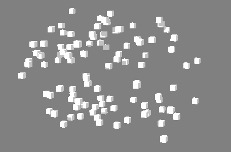

Alters the visibility of instanced objects.
Visibility Node
- Random Strength
- Sets the number of objects to randomly turn invisible.
- Step Strength
- Turns the objects invisible one at a time. By default, this is done in the order of their IDs.
- Filter on
- Corresponding object IDs will remain visible, no matter the other values. You may enter individual object IDs (i.e. 1, 3, 5) or number ranges (i.e. 2-6).
- Filter off
- Corresponding object IDs will remain invisible, no matter the other values. You may enter individual object IDs (i.e. 1, 3, 5) or number ranges (i.e. 2-6).
- Invert
- Reverses the order in which objects are made invisible.
- Random Seed
- Alters the randomization for Random Strength.
