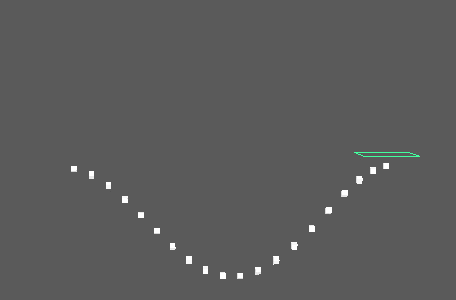

Reflects a MASH network across a line of symmetry. Automatically creates a mirrorPlane object to act as a reference point.
Symmetry
- Placement
- Determines the line of symmetry. Options include:
- Mirror Plane: Uses the mirrorPlane as a reference point to mirror across.
- Bounding Box +: Uses the positive bounds of your MASH network.
- Bounding Box -: Uses the negative bounds of your MASH network.
- Axis
- Determines the axis to mirror along.
- Enable Rotation
- Pass rotation values through the Symmetry node.
- Allow Negative Scales
- Allows MASH to turn geometry inside out (i.e. a value of 1 reflects to become -1).
- Offset Position
- Alters the position of the mirrored network. Initially connected to the translation of the mirrorPlane.
