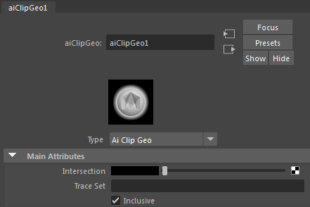

See Utility Shaders in the Arnold User Guide for the full shader documentation.

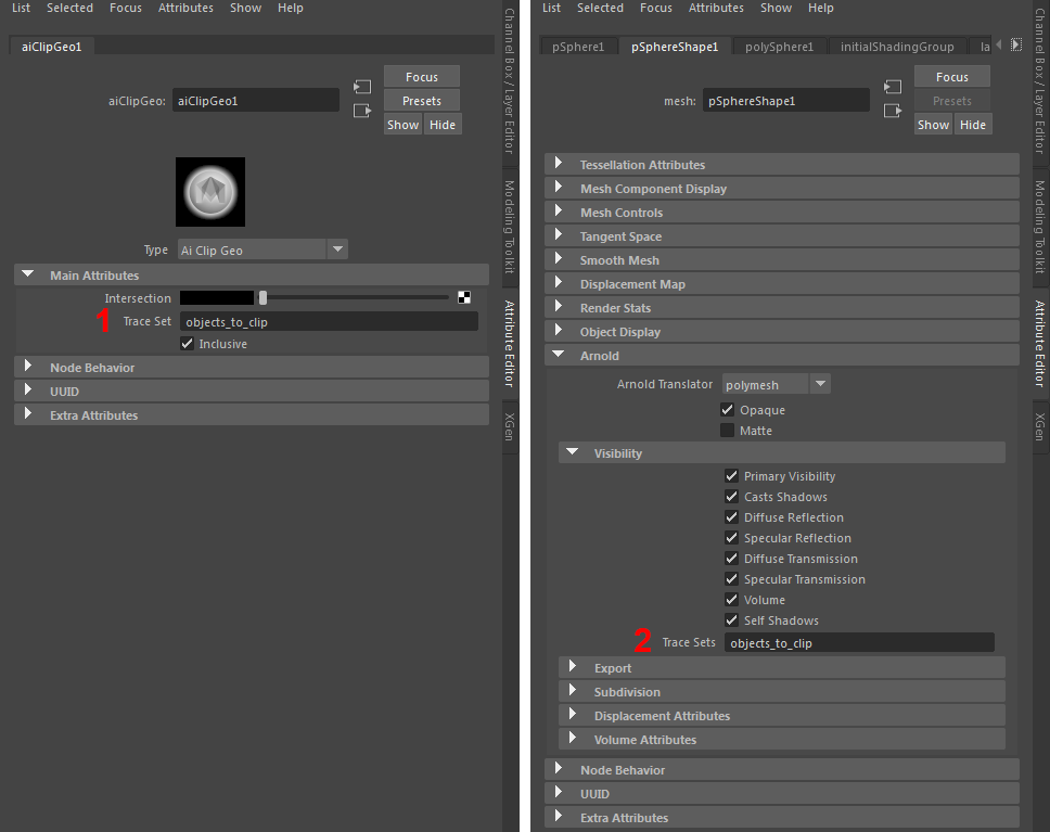

The clip_geo shader makes a shape a 'clipping shape'. A clipping shape clips geometry from any shape that intersects with it.
Trace Set name (objects_to_clip) given to clip_geo shader (left) and clipping object (right).
