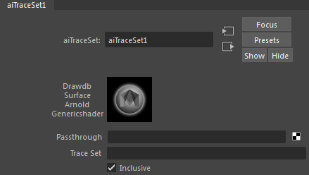

It is possible to designate objects to be part of one or many trace sets. The trace_set shader marks specific rays with an inclusive or exclusive trace set.
Tip:

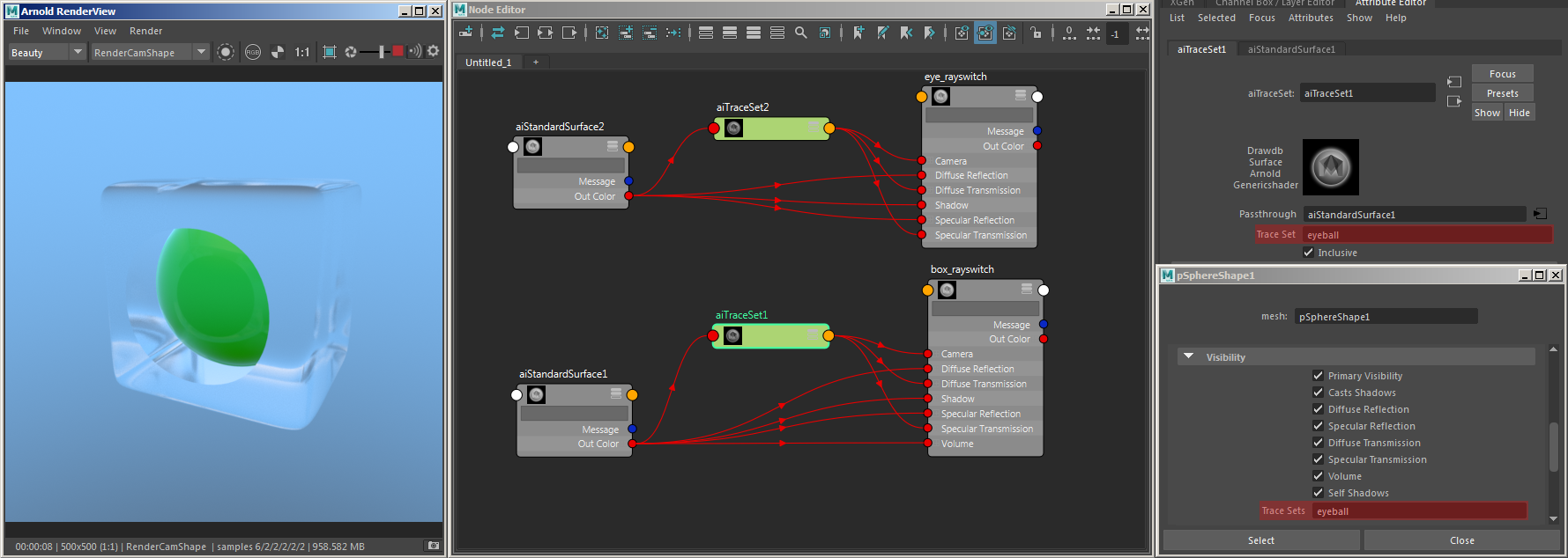

In the Arnold Visibility attributes, it is possible to tag objects to be part of one or many trace sets.
| A scene file is available here. |
'Eyeball' set in Trace Sets of sphere and shader.
