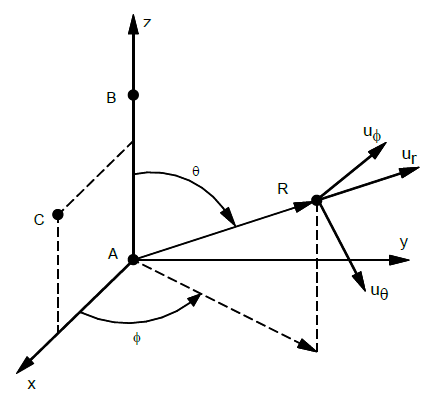

Figure 1: CORD2S definition

- The location of a grid point (P in the sketch) in this coordinate system is given by (R, θ, ϕ) where θ and ϕ are measured in degrees.
- The displacement coordinate directions at P are dependent on the location of P as shown above by (ur, uθ, uϕ).
- Points on the z-axis will not have their displacement directions defined in this coordinate system since a unique values of θ and ϕ cannot be defined on the z-axis. For the case of points on the z-axis, the basic rectangular system will be used for displacement output.
