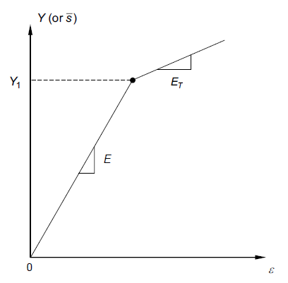

Either the table identification TID or the work hardening slope H may be specified, but not both. If the TID is omitted, the work hardening slope H must be specified unless the material is perfectly plastic. The plasticity modulus (H) is related to the tangential modulus (ET) by
where E is the elastic modulus and
is the slope of the uniaxial stress-strain curve in the plastic region. See Figure 1.
Figure 1: Stress-Strain Curve Definition When H is Specified in Field 5.
If TID is given, TABLES1 entries (Xi, Yi) of stress-strain data (εk, Yk) must conform to the following rule: the curve must be defined in the first quadrant. The first point must be at origin (X1 = 0, Y1 = 0) and the second point (X2, Y2) must be at the initial yield point (Y1 or 2c) specified on the MATS1 entry. The slope of the line joining the origin to the yield stress must be equal to the value of E.
